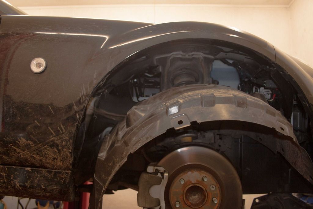

Therefore the car was lifted and the wheels removed.
The wheel arches liners on the front of the car do not come off completely as you see they hang down.

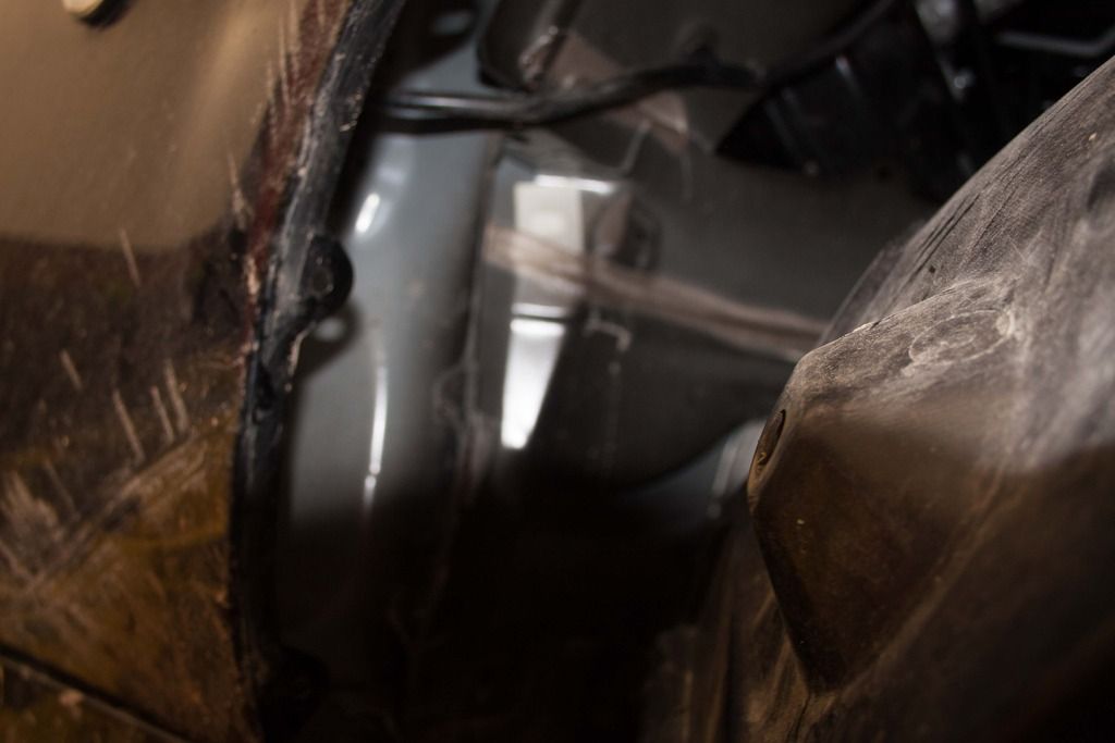

The only problem that causes is the space between the rear of the wheel arch and the front of the door is harder to see into to get the goo in there. You waste product as you get so many areas you miss and have to do again but you cannot see what you are spraying.
The usual missed area of rustproofing.

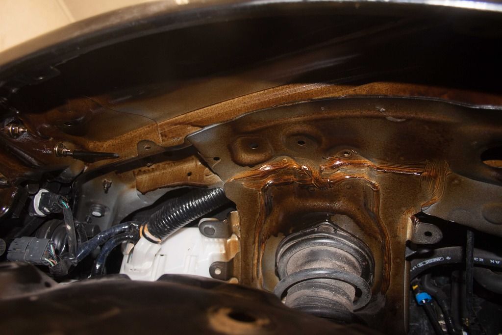

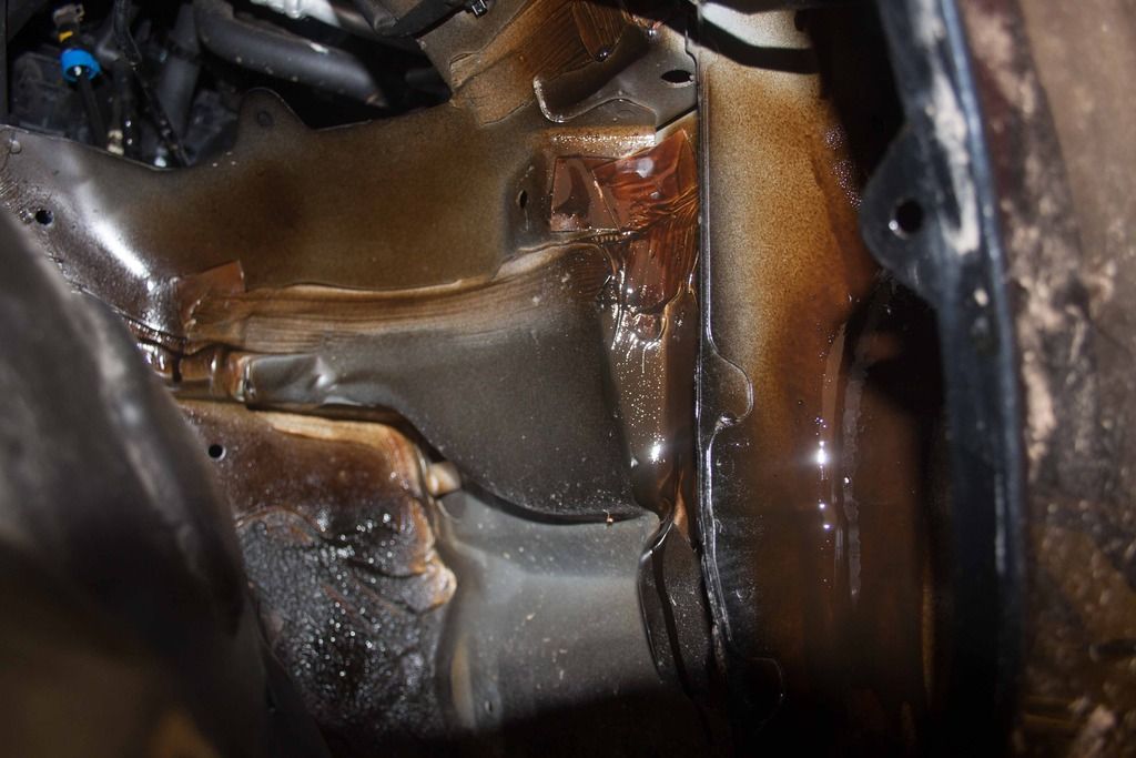

The front wheel arch treated with Dynax S50 as are all the areas under covers or in the sills or inside the chassis rails.
By 3:30 pm we had the wheel arches and underside completed.
The next session later in the month will be the engine compartment, the front of the sills, the doors and the boot internals.
We used Dynac UB on the underside areas that are subject to abrasion from the road and we will use Dynac UC clear wax in the doors, engine compartment, door internals and bonnet undersurface.
